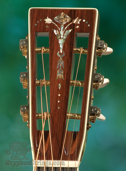

I'm making my first slotted headstock (steel string) and I'm trying to get from this:
To this:
So how do you guys go about squaring up the ends of the slots? I figured I'll just do it very carefully with small sanding blocks. But it turns out that very carefully also means very slowly, and the longer it takes to get it right the more chance I have of screwing it up.
So anyone have a clever solution? For some reason the rounded ends, to me at least, look unfinished. Also how do you lot put in the ramps without marking the sides of the slots?

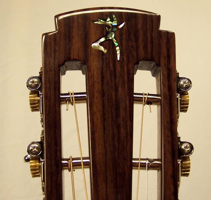

I used a combination of chisels, files, and a sanding block to get this. Note that I hadn't polished the finish in the slots when I took this picture.  The cleaned up fairly nicely but were a pain in the neck to do.  I don't think I will do another like it!
PostPosted: Fri Sep 21, 2007 2:22 pm
David,
That is an exquisite piece of work!
